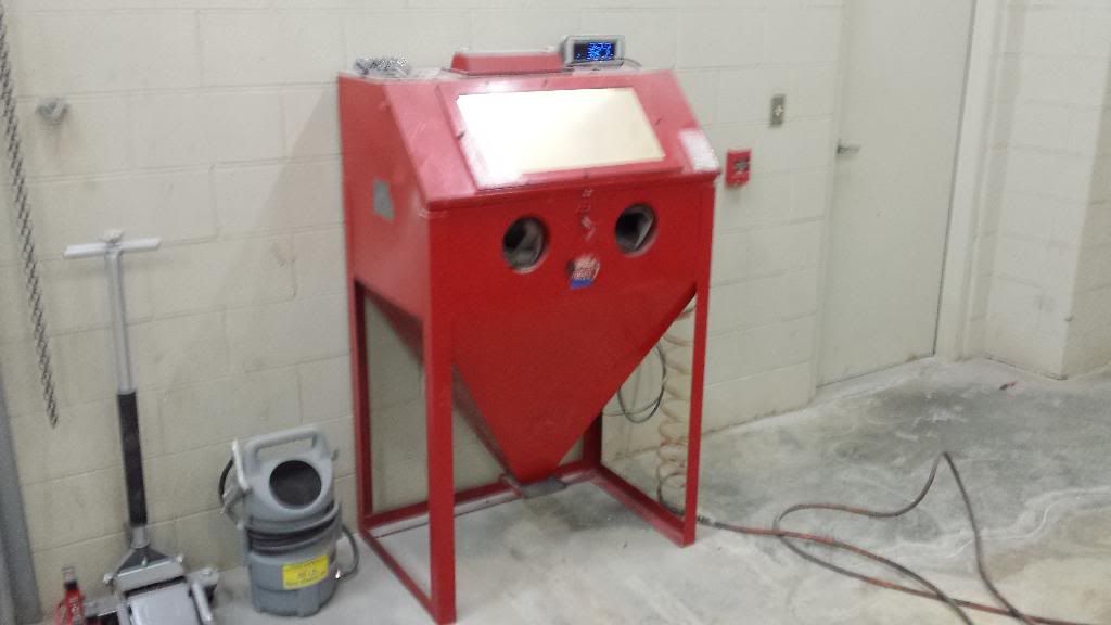

Cleaned all the old garnet/abrasive out of my cabinet and loaded it up with 30lbs of no.14 ultra fine glass beads.

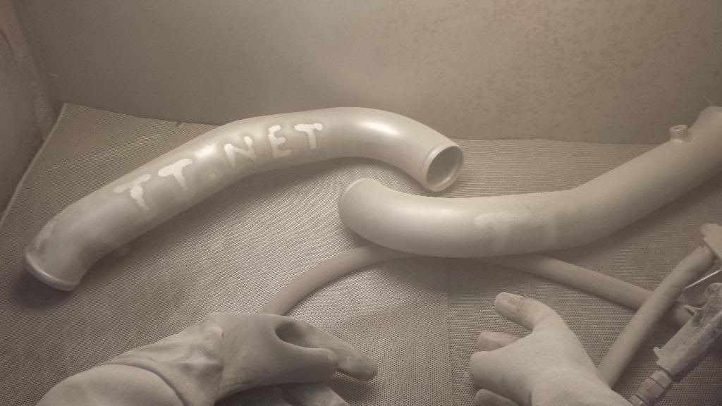

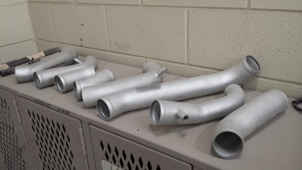

Took roughly 3hrs to remove all the silver powder coating off the piping (28 linear feet).
 photo 20140105_164656_zpsdzpmyjfv.jpg">
The blasting left the pipes slightly reflective with a very smooth, silky/satin finish. The glass beads produce very little dust, and have a 30x recycling rate so the 30lbs lasted the whole three hours.

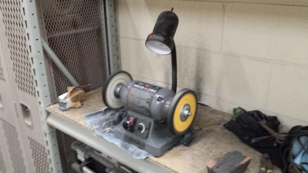

Setup my grinder with the cutting/buffing wheel on the right, polishing wheel on the left. Advise from experience... Harbor Freight sells the worst polishing pads, compounds and attachments known to man. I picked up these pads from Lowes and they've been excellent and durable.
 photo 20140105_140845_zps2w0esi3d.jpg">

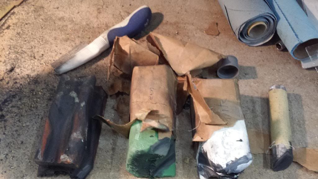

Straight from the blast cabinet, the pieces can go right to the buffing/cutting wheel. I bought a 16oz block of each of the following compounds as I plan to polish everything possible as I rework my engine. Red is your starter compound and will level out the surface and produce a decent luster. Periodically rub more onto the wheel as you're going, and every 15min or so, I recommend raking the wheel with a blade (I use a flea comb) to remove excess built up compound and soften pad.

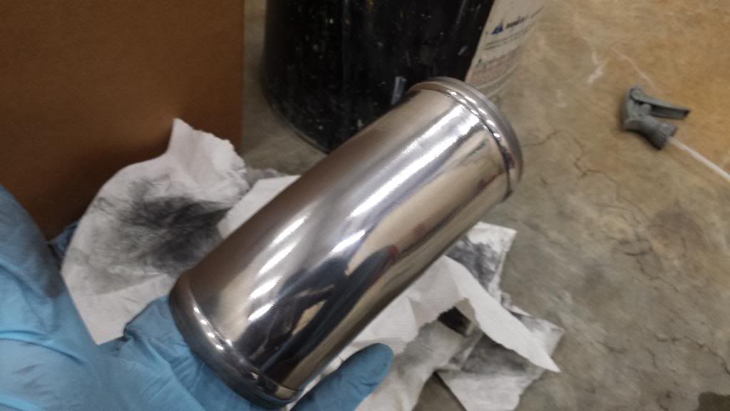

Five minutes into buffing, wiped down with acetone before moving onto the polishing wheel with white/green compound.
 photo 20140105_150032_zpshf6mdkkb.jpg">

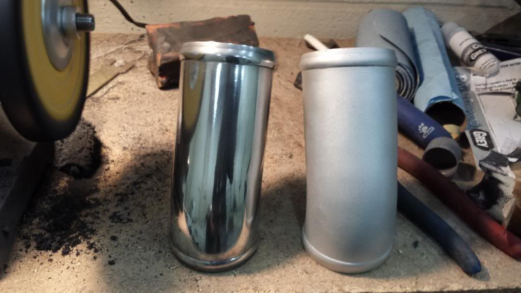

Side by side with blasted and finished pipe section
 photo 20140105_144329_zpscoqyylib.jpg">

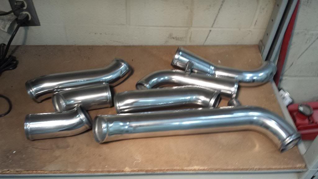

Here's what I managed to blast and polish in 8hrs today.
 photo 20140105_170429_zps6u45muvm.jpg">
All in all, it's a lot of standing around and letting the tools do the work.
